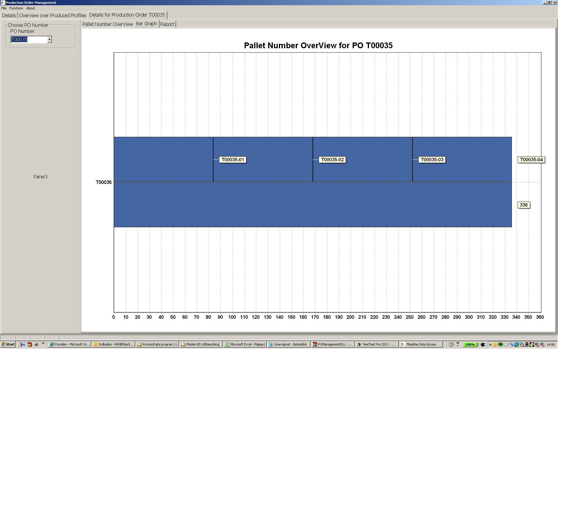

Why Can’t I see the Labels on the HorizBarSeries??
The Labels are only visible for only for two of the bars in the ThorizBar. For the remaining bars, the labels are hidden below the bars??

When you work with stack bars, the marks of bars are hidden bellow bars, except the last bar you draw, to achieve that you can see all marks of bars series you need enable the property of Marks OnTop for each series that allow you access in all marks. You can do something as next code:
Chart1.View3D:=false;
Series1.FillSampleValues(3);
Series2.FillSampleValues(3);
Series3.FillSampleValues(3);
Series1.MultiBar :=mbStacked;
Series1.Marks.OnTop:=True;
Series2.Marks.OnTop:=True;
Series3.Marks.OnTop:=True;
I hope will helps.

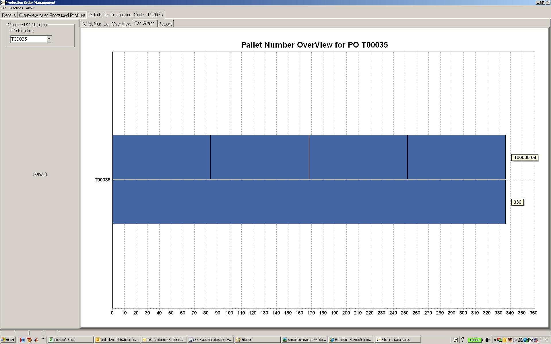

Can I move the label so that it is located on center for each bar??
As shown on the attached bar; the labels are located next to the individual bars; I would like to have the marks located on the center of each bar?
Hi Friis,
Give it a try to the MarksOnBar and MarksLocation properties:
http://www.teechart.net/support/viewtopic.php?f=3&t=13551&p=59286&hilit=marksonbar#p59286
