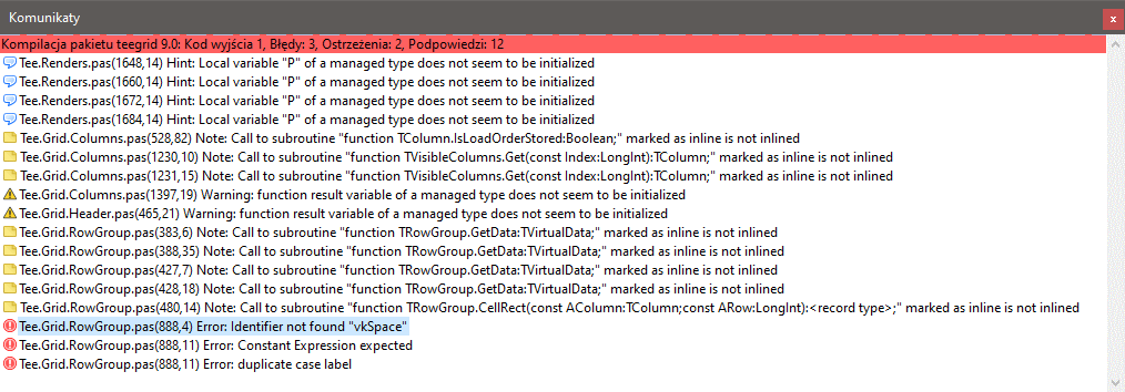

In Lazarus I opened teegrid.lpk package and tried to Compile.
In Messages window of Lazarus IDE I founded some errors (screenshot):
Tee.Grid.RowGroup.pas(888,4) Error: Identifier not found “vkSpace”
Tee.Grid.RowGroup.pas(888,11) Error: Constant Expression expected
Tee.Grid.RowGroup.pas(888,11) Error: duplicate case label

Hello Pawel,
We are sending a link to your email address with a download to a version that resolves the issue. We expect to include the correction with the next update-release build.
Hello Marc,
I download zipped files that You sent. Now was no problems with installation :slight_smile:.
Thank You very much!
