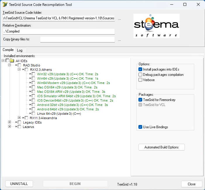

TeeGrid 1.18 seems to compile and install fine for RAD 12.3 here:
Check permissions for the target folder.

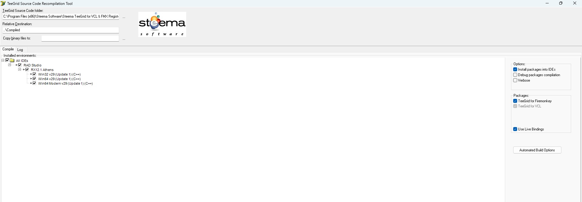

I also started the steema setup in admin mode, so the permission for the folder should be there. But this doesn’t change anything, same problem, the setup doesn’t recognize the delphi componet.
The RAD studio itself works fine, I can start and compile my Delphi programs as usual.
The installation process itself is straigthforward, nothing much to configure. Actually, I used the presets and didn’t change anything, so there are also the default installations paths (for the RAD studio and also for the Steema TeeGrid setup).

Please make sure you are logged in with a user that has enough privileges to write in that folder, or just run TeeGridRecompile tool “as administrator”. It shouldn’t give permission errors.
