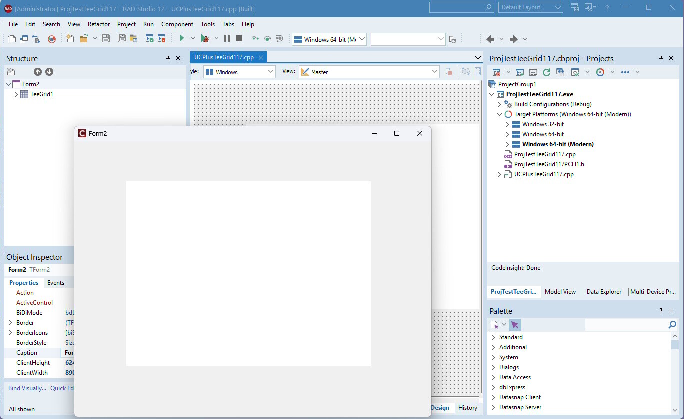

Hello support,
i encounter the same issue.. only when i build as a win32 fmx application.
reproduce :
  • Create a new multiplatform application c++
  • build and run successful
  • drop a teegrid component (1.17) on the form
  • build/run gives the error TeeGrid1 ._Headers:invalid property value.
  • switch to 64bit
  • switch back to 32bit
  • open form as text and remove the _Headers section
  • save file
  • close file and do not open the designer
  • open form
  • open designer and move the teeGrid
  • save the change
  • build/run gives the error TeeGrid1._Headers:invalid property value.
    My applications consists of many lists where the teegrid is used. normally i make 64 bit applications only but for a project where i only have access to specific 32bit libraries i ported my bases forms to 32bit.. the workaround may work but is not workable and not maintainable..
