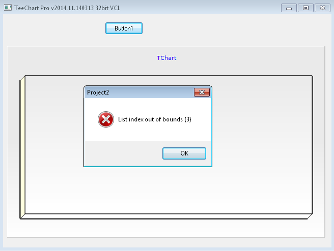

this version does not open dialog at all.
(Even in chart editor if you try to change series type (Change button) it does not open anything).

Now I had time to check this, and it seems that in this version in code active tab was left to Templates tab (TeeGally.pas) (and it is not visible when you call GetChartGalleryFunction, so that was reason of List index out of bounds (3).
Otherwise it is now working, thanks!
